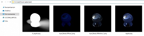

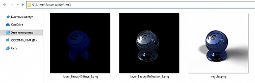

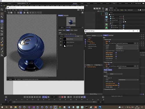

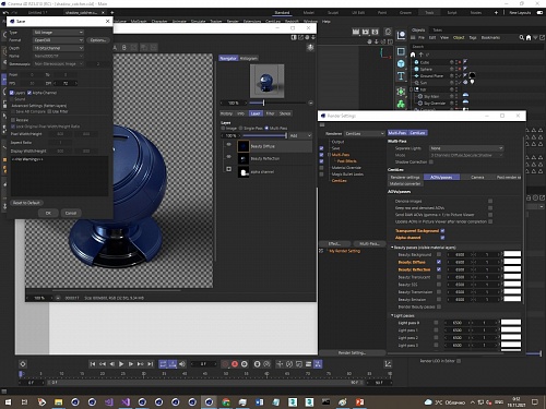

I think we have missed the Multi Pass checkboxes in render settings. They are enabled automatically when user enables the Light passes or Beauty passes, but it was missed to do so for Alpha channel. But anyway I recommend to select what is highlighted on the image below: the Alpha channel, Diffuse, Reflection, and Multi Pass / Post Effects on the left menu as highlighted.
Then after re-render in PV you will see the image and layers in Layer tab. If you select "Multi-Pass" option in this tab the checkbox "Layers" will be activated in the Save menu for this image (see at the left side). This works for manual saving after render is done.
But really the Alpha channel output can be enabled if we make automatic render image save. This can be enabled using Save Settings (keep attention on highlighted settings):
1) To save the regular image (beauty main of centileo) you use the usual Save file of the Regular Image tab.
2) To save the layers you have to setup the Multi-Pass Image tab settings and setup additional Save filename, also use layer name as suffix.
3) If you enable the flag "Separate Alpha" in Regular Image tab the Alpha Channel will be outputed as a single separate file with "A_xxx" prefix.
4) If you disable the flag "Separate Alpha" then Alpha channel will be embeded to regular image (our beauty image) and it will get transparent background and semi-transparent shadows:

Yes, this is because of this. I have tested Cinema 4D exactly for this for several hours. So, it has Alpha channel for rendered image and it's applied on not only for main beauty image. It can have Separate Alpha On/Off:
1) In case it's Off then the Beauty image has transparency, but other passes still don't have (Diffuse, Reflection).
2) But in case it's On we get all images without Alpha channel and Alpha channel itself is stored as a separate image.
I think that case 2 is good, because you can re-apply this Alpha image to any image pass in AE. I don't have AE now, but I think it should be possible, it looks as something basic: the 4-th channel :)

Glad, you fixed this! Btw there are also options in C4D file saving something like "Straight Alpha", "Pre-multiplied Alpha".
Also in CentiLeo render options (in AOVs tab) there is "Transparent Background" option that also kills the reflection of background on reflections as far as I remember :)
