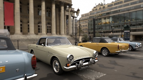

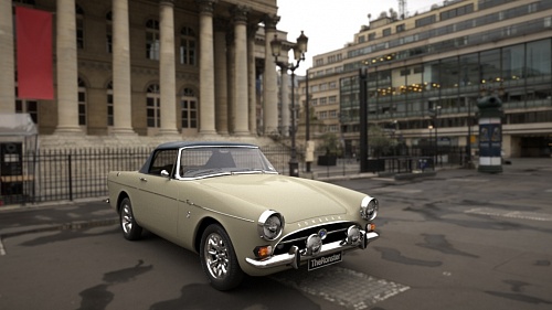

Quick render using an old model with new renderer
Hi This are quick renders of a Sunbeam Tiger sports car from the 1960's. The scene is a simple spherical HDR image with a ground plane with a shadow catcher material which Kirill kindly explained how to setup. The most incredible thing is that it's so fast to render and with great results, with low settings. The images with the single car took 10 second while the multiple vehicle images took 11 seconds on my i7 4790 with 16Gb ram and GTX 1060 6Gb ram. It's set to render with 3 to 4 Iterations with 4 Ray bounces. Even with a little depth of field the rendfertimes are almost the same. What I'd like to do next is learn how to add 'Decals' to Centileo materials to give a true race car advertising look!

Hi Ron! Very nice renders! Btw, it will be fast even if the car headlights are made not from bitmaps but from real glass, bulbs, etc (with a lot of refractive geometry). CentiLeo is fast for such materials.
