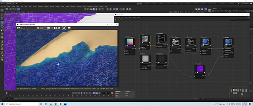

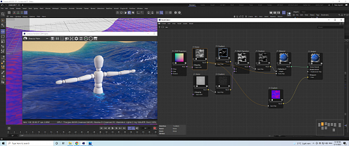

This is updated, using a normal map and noise for the bump.
I tried changing the subsurface radius scale and some of the radius values.

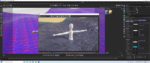

I also tried using transmission set to 0.3
but you suggest translucent instead?

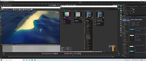

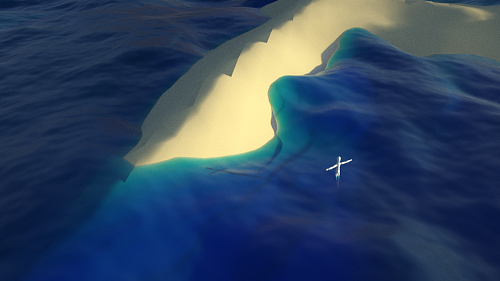

This is my new attempt. The second image is with the normal map scaled down to 0.1

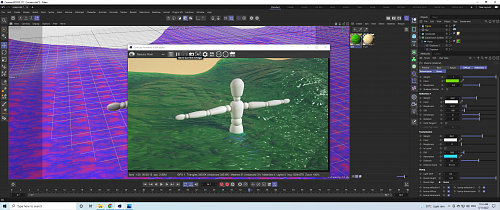

When I darken the Absorption blue colour in Transmission channel it makes the water appear grey and not blue.
What do you mean radius changes? Which channel? I thought only subsurface has radius. Unless you mean the distance scale?
I had turned off subsurface and just used transmission absorption to get the blue colour.
When I reduce the HSV v value I get the grey look. But if I reduce the h value I get this nice light blue near the rocks.

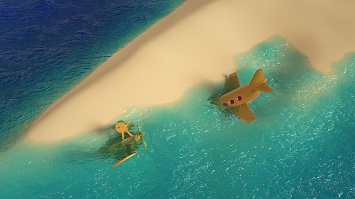

This one is a quick setup using a plane with noise displacement.
I used a landscape object as sea bed, added a diffuse material as sand.
Water is just a plane with 100x100 subdivision, used displacer deformer with animated noise.
A clear blue sky with visible sun is used as the hdri ( if I change to other hdri, the result will be different).
For the ocean material I used diffuse+reflection+refraction(transmission) technique. Also added a noise texture as bump.
Diffuse color is a bright turquoise blue.
Reflection is default but adjusted the IOR and roughness value.
Transmission value is doing the magic here.
Use the value between 0.9-.98.
Adjust the absorption color (any blue color) and distance value.
Not the best technique, but will work with any other renders also.

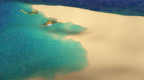

I tried using diffuse again instead of transmission absorption for colour, and I kind of like it better now. And my normal map reduced scale I think gives more detail in the third image.

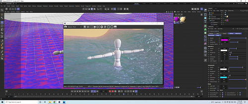

Sorry for the confusion, here is my material setup,
