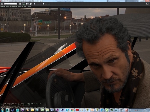

few 8K-8K textures, 8K HDR, 40M poly, 36 lights.
Just started to make materials as I am being a programmer can.
One thing that we need to improve is the scene load time. Render is fast, interactive experience is also very fast.
Obviously need to make SSS/refl for skin material. It's just diffuse yet
