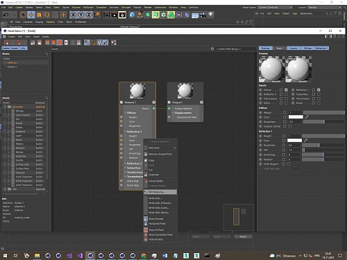

To edit the node materials there are few steps:
1. Open Cinema 4D in developer mode with Administrator rights. There are 2 options to do this:
1.1) Edit the properties of Cinema.exe shortcut. This shortcut of exe file can be found in windows task panel. In the properties of shortcut edit the launching object to this string:
Code
"C:\Program Files\Maxon Cinema 4D R21\Cinema 4D.exe" g_applicationRepositoryWritable=true g_developerNodeEditorFunctions=true g_descriptionEditorDeveloperMode=true
It just changes the command line params to developer mode when you launch Cinema using the shortcut.
1.2) Alternatively, open CMD.EXE with Administrator rights and type the same string to CMD and press Enter keyboard button
Code
2. Since you launch Cinema in developer mode create CentiLeo node material, right-click mouse on material node and click "Edit Resource".
In the opened window you will see the interface of this particular node.
3. Change the language interface to Chinese in the node editor development (zh-CN) in the top left corner.
4. See the orange highlighted strings as on the image below to get the idea how to modify the strings that are used as translation.
5. The other CentiLeo nodes can be selected for editing in the top left corner in "Id" line (2 rows to the down from Language).
6. After you have finished your editing you should click to the top menu item Database and select "Save all Databases".
7. Your changes will be saved in the files in this folder (this is the CentiLeo plugin folder and it's internal "res\nodes\" subfolder)
Code
C:\Program Files\Maxon Cinema 4D R21\plugins\CentiLeoR21\res\nodes
As you can see currently this folder contains 2 .json files. They contain a structure and a language file of the interface. We are interested in the zh-CN language file only, don't pay attention to the others.
8. The resulting .json files for R21 in our example after you have saved the Databases can be copied to the other plugin versions for R22-R26 or 2023. All .json files are the same for all Cinema versions for CentiLeo.
9. The other optional way to open Resource Editor is to click the "Search" icon in the very top right corner (under the close X button), and type "Resource Editor" there. In the opened window of resource editor select the language and the database "com.centileo.nodes.module"
