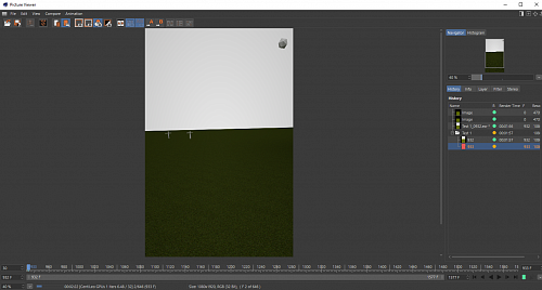

I uploaded a sample frame; should this take 2 minutes to render?

What's your scene? What is this green field? A texture? A forest? Surely it looks strange slow. Please can you send me this scene file for tests? I am curious what's whong there.

Btw, in previous message I have shown 6.48 iterations performed in 2:22 min. And now I see 16.14 iterations in 49 sec. Strange! But I will look inside :)
Thank you for files sent, I see them and will check soon!
That screenshot is from a frame still in progress, but the 32 iterations (I left as default) took about 2 minutes.
