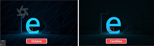

As far as the emission material is concerned, I hope it can be more refined. The following is a comparison of the two renderers. Look carefully at the outline of the letter e.
Compared with no other malice, pure hope is getting better and better!

Apr 13, 2023 21:56 I like the Centileo GPU renderer very much, it is very fast and the effect is good!
As far as the emission material is concerned, I hope it can be more refined. The following is a comparison of the two renderers. Look carefully at the outline of the letter e. Compared with no other malice, pure hope is getting better and better! |

Apr 14, 2023 05:54 Hi rush.a and welcome to CentiLeo! Thanks for good words! I think the reason of difference is that in case of CentiLeo there is only Emission property, while in case of Octane there is Emission + Diffuse mix. Probably Octane Emission is implemented with some slight amount of diffuse property. Please try to combine Emission with Diffuse material using MixMaterial and see what happens.
Best regards, Kirill
