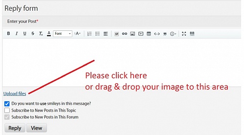

Your image hasn't attached correctly, please, can you drag and drop it clicking Upload files or moving your image to the area with "Upload files" in Reply form
