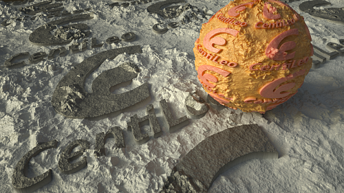

Hello everyone!
We can finally release an update CentiLeo 0.55 for Cinema 4D with new displacement mapping engine. There work was so long because there was a lot of R&D and new algorithms were created to make DM efficient.
We have opted to make DM based on geometry pre-tesselation because we want it to support arbitrary shader networks as input and to make vector displacements too. Both these things are impossible without pre-tesselation. And with this fact many problems may happen like huge poly-counts, screen adaptivity artifacts, not so fast tesselations and renderings. However, we have solved many of these. Btw, there are still some drawbacks and vector displacements are not yet added, but we will fix that at later stage.
See this changelog to get the idea how new feature works. We now turn attention to mesh lights and many new shader nodes.
Please, test it and share your opinion!

Administrator  Posts: 972
Jun 7, 2018 14:08
i just test a sample scene with displacement take 00.50 seconds and without displacement take 00.33 seconds . loading and memory it is so awesome .
Jun 7, 2018 15:52
Displaced version is slower than without it just because it has more polygons. More polygons for same scene produce slightly slower rendering. But if you model everything with same polycounts the will be same situation
Jun 16, 2018 08:31
0.552 update: Improved displacement precision in pixel adaptive mode for animated walkthrough.
In the past there were subtle waves on high-frequency displacement surfaces during animated walktrhough even when Edge size is 0.5 pixels (and Adapt to pixels ON). Now this artifact is removed for Edge size equal to 0.5 pixels. But still need to improve things for Edge size = 1 pixels with a more sophisticated aproach.
Btw, there was no wave problem during any animation for Edge size in world units (with pixel adaptation disabled). However, if tesselated in this mode there could be more polygon data generated than for adaptive pixel mode.
