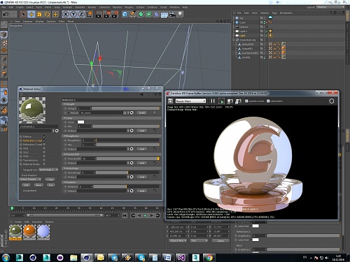

Cool I haven't seen that video. They are connected with PCI express 16x all 7 of them, they are all cut to single slot manually and watercooled. On a different note I noticed that when I load a colour correction shader and fr om there I try to load a bitmap C4D freezes. Also a small list of things that I have as a wishlist:
  • It would be nice to be able to dock the ipr window
  • support for native c4d shaders (noises etc) even if baked and also the ability to copy paste channels in the same way as in C4D
  • there is something wrong with the reflection and the reflection weight also the roughness needs different scaling, at 0.1 it is already too much, look below it seems at 0.1 roughness the weight plays no role anymore, neither does ior, only if I bring the diffuse weight down to 0.5-0.7 the diffuse looks normal, but then If i raise the ior the material gets much darker and in the corners wh ere it should be brighter because of reflection it gets darker, it is confusing, and I know how to make good materials in Vray, Octane and all the rest of the renderers out there so it should be easier for me unless I'm missing something. Edit:It happens between 0.01 and 0.011 or more, it jumps to more than it should I think it is a bug?
I agree about the range of roughness. Should remap it. Currently the idea is to map current roughness=0.5 to new rougness=1. What do you think?
It seems there is bug and need more clarifications. I mean
Please can you share your test scene where the error is clearly visible?
E.g. in 2nd and 3rd images you have roughness 0.1 but when you have Weight = 1 and IOR like 1.4 then this value of IOR produces increased weight at surfaces with orientation close to 0 degree and decreases weight for surfaces oriented towards the viewer at 90deg. However when you increase IOR up to 20 or 100 then there should be uniform reflection under any angle of view.
But when you decrease the Weight then it scales down what is given by IOR. E.g. on you 3rd image you have increased IOR to 20 (it's everywhere almost a mirror). But the weight is 0.2. So there is 20% mirror and the rest is for Diffuse.
I have played in our test shaderball, it seems to be working as planned.

Ok, thank you for your reply, that's how I did it first but then I put the colour correction first and it crashed. As for the reflection problem, It is not working as expected, In the test file I send you, if you put the roughness from the 0.01 that I have it, to 0.011 or more, you will see a huge jump in the brightness of the texture, that shouldn't happen, I can provide examples with other engines if you like, but see it for yourself. Also the mapping of roughness should be fixed as you said, It is way to strong at the begging for very small values 0.02, 0.1 etc, and later it picks up.. maybe it should be non linear, I don't know... Here's the file :

Konstantinos Despotis, thank you a lot for upload! I notices what you are talking about. Indeed it's a bug that is clearly visible on your shaderball (I guess it's from Corona :)
In our few test scenes the lighting conditions haven't given so obvious picture of this bug.
The roughness should be not linear. I will test it face-to-face with other engines in order to calibrate it better.

Konstantinos Despotis, I have fixed that bug when jumping 0.01 to 0.011. It was a stupid mistake :)
Now the roughness works like this: animated roughness from 0 to 1 (no bug and better mapping):
https://www.dropbox.com/s/hbmo4zgw368jt9n/roughness.avi?dl=0
This is anumation of IOR changing from 1 to 4 (when become large it looks more like a metall):
https://www.dropbox.com/s/clwjcz71tzg4snf/ior_rough015.avi?dl=0
