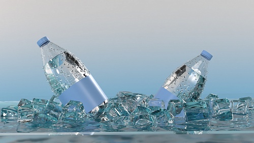

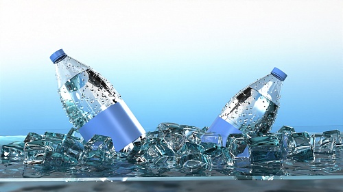

GTX 1660 card is used for rendering. Centileo in C4d 24 and RPR (prorender) in Blender 3. I tried to match all the materials as I can, then adjusted the lighting.
It seems doing a lot of trial and error Centileo can be matched to RPR. Previous renders were done with denoising on and this one without denoiser.
1920x1080
Both renders were run on 6min,
no denoiser, no dof, no motion blur
Centileo 2.25 iteration ray bounce 14
RPR 356 samples
More test renders with dof and denoiser
Centileo dof denoiser ray bounce 25
RPR with dof and denoiser

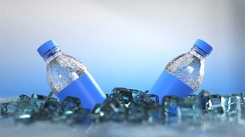

I really like the ice and water renders of RPR, any idea to push Centileo to do so?
Definitely Centileo can make good renders, waiting for Ambient occlusion, render pass, caustics, volumetrics etc.
And here is the renders with reflection on/off for the bottom water layer.
No reflection
with reflection
IOR value for refl and refr is 1.33, no roughness, blue tint for refraction color.

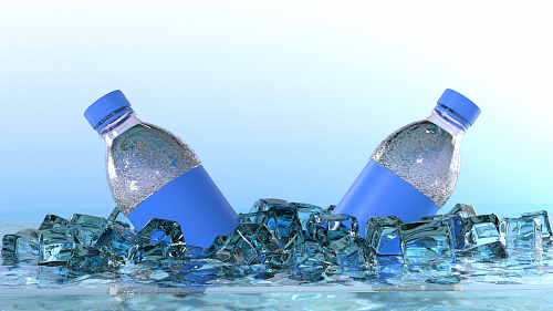

RPR seems to produce more lights/exposure than Centileo with same HDR. There is no exposure/ camera values changed in both renders. RPR may be shooting more rays?
with ray bounce =25 and post effects on
with c4d filter exposure=0.5
is liquid= on for water inside bottle, droplets, ice, water body, centileo exposure = 1
cl c4d exp 0.jpg (956.5 Kb)

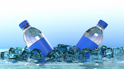

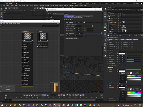

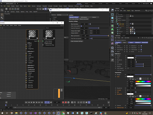

Hello! I have checked your file and have fixed few material settings that I think are right now. Have a look at my screenshots and material settings. It seems the ice looks nice now. I have fixed the colors: transmission color is white, but absorption is not white and distance is smaller, check it. Also the Clamp params of render settings are increased. Also the icecubes have "Is Liquid" setting Off. For some fun I have switched on the top light source. Sorry for long waiting for reply, I was extremly overloaded with new version development :)
Water material:
Ice material:
@Kirgman Thanks,
The ice and water look nice now. I never tried increasing the clamp values before.
Changing the IOR of ice to 1.5 and absorption color and distance seems to solve the issue. I have tried these settings before but was stuck at distance value and also with the default clamp light settings there wasn't much clear refraction happening on the middle ice cubes.
In prorender, there was refraction color added to the ice and tried the same color in Centileo before, it is rendering in different way. It seems like both renders handle things differently. I used the same material settings from Centileo (your settings) to RPR and the render is extremely different.

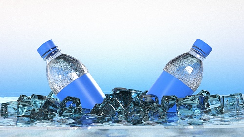

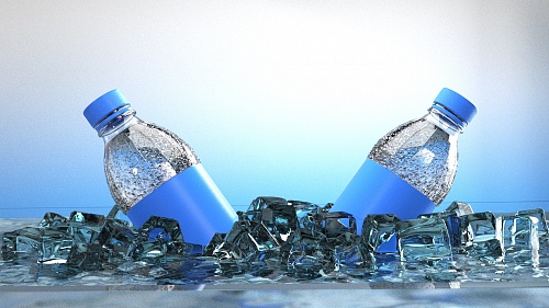

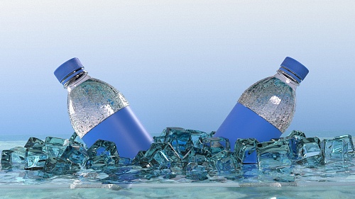

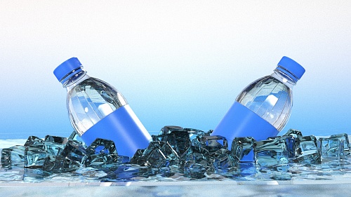

The post effects influence the scene very much, I did a couple of test.
Centileo with post effect (default)
Centileo post effect turned off
Centileo with custom post effect (override)
Did some adjustments on the same renders using c4d filter.
Centileo post effects default + c4d filter adjustments
Centileo post effects off+ c4d filter adjustment

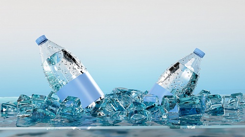

yes, the water droplet need more works, this one is just a hemisphere. I have other scenes with properly modeled water droplets.

Displacement may work good for simple geometry, may be for the above bottle. I have done several test with other renders using displacement map for similar scenes, but couldn't get the desired look. Too much jagginess and weird refractions with displacement.
The droplet is actually cloned hemisphere. I used it for simplicity. I have other scenes with properly modeled water droplets cloned on the bottle surface. I followed a tutorial long ago and created some dripping effect with thinking particles. Unfortunately I don't have access to those scenes now (my hard disk has some issues).
Here is the link to the tutorial https://lesterbanks.com/2013/01/creating-animated-water-drops-on-an-apple-using-thinking-particles-i...
Frosted look for ice cube is also done with other render, I used bubbles, cylinders inside the ice and applied different ior, for ice used some bump map and roughness in the refraction.
I never used sss with highly refractive scenes, too much to calculate. But with Centileo I may try.
