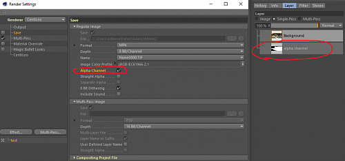

The Transparent background option removes the HDRI image from the main render image. You can save this background if you check the "Bacgkround" pass.
But maybe your issue is related to the "Alpha channel" option in Render->Save option?
I thought the alpha channel only matters if there is actually an alpha with no background.
I assumed the background would make it not have alpha and save the background instead.

Have you checked premultiply by matte option in After effects?
Some times disabling the matte in interpret footage may show the background.
footage>interpret footage>alpha>ignore

good point. I will try that.
it makes sense because I'm certain the background must have been saved as the picture viewer shows.
