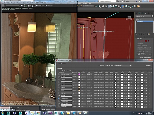

Here is my quick test in Max 2017! It is installed and is working very well. I like the left most button which jumps to Modifier editor with full settings.
Few remarks:
1) When light is switched off with checkbox the dropdown box for Type is deactivated. And when it is switched on again then the dropdown box for Type is not activated again. I think it can be always be active regardless of on/off state.
2) We have too many tweaking controls for the light source. And there is no yet textures there. Will need to think how to make it more ergonomic. At least the Multiplier can be removed, becuase there is Intensity there
There are some exceptions regarding garbage collector when installed it to Max 2014 and run the light lister. However it was running together with 2017 and IPR in both Max instances. Will have to check it alone.

Hi Kirill,
Fixed
Will update it via new features and try to keep it simple and useful
Will take a look at it.
Thank's for letting me know.
