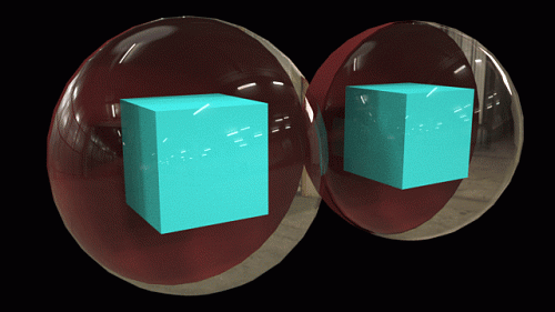

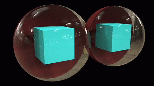

(this is a GIF file, click on the image; if not played download the attachment.).
You can see the GI flicker in the right cube, reflection in the left sphere.
One hdr and a sunlight lit the scene. Left sphere has no thickness, right one has thickness applied.
Iteration value 8.
Iteration =16
All other centileo parameters are default.

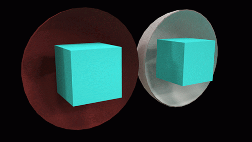

No glass, max iter = 16.

thrimanakatha wrote:
(this is a GIF file, if not played download the attachment.).
I hdr and a sunlight lit the scene. Left sphere has no thickness, right one has thickness applied.
Iteration value 8.
Iteration =16
Yea I can see it.
Even with 32 iteration the gi flicker is prominent. Did some test with placing the object inside a cube, lighted with a single area light. There wasn't any noticeable gi flicker. But the scene took 4 min to render with default settings at 640x360 res.
