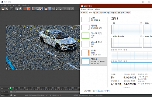

i want to know how fastest rendering settings
and heres my setting value
It took a long time to rendering so i reduce my function value
this is when the computer is interpreting the rendering
i don't know why my gpu card using 5%~16%??
If it's the standard, wouldn't it be normal if it came out 100%?

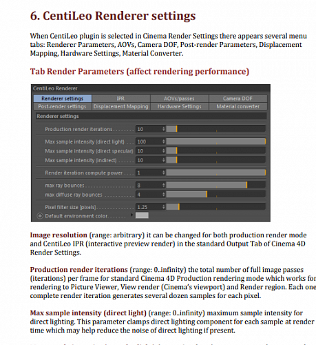

I read the catalog because I was wondering what the problem was. '
I've got what I'm looking for yeah!!!
"Render ITERLATION COMPUTE POWER"
but there is nothing change function value tab...

I found something unique while using it
if i used centileo IPR viewer gpu usage 20~30% and little bit faster than picture viewer rendering
but i need animation scene and export MP4 file
please help me this problem thank you

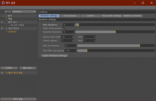

You can speedup the render by reducing the max iteration 1-2 and use denoise.
Just use ipr and check the iteration values, depending on the scene the bigger noise may clear around iteration value of 1.
I use 1-2 depending on the scene and with denoise always get reasonable result within a minute.
Unless your scene too complex to compute there is no use keeping higher iteration values. Just make sure static noise is turned on and use denoise.

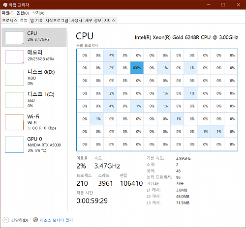

Man, you have 48×2 core cpu running at 3ghz, then why gpu rendering?
physical render can render your scene within seconds if you setup the scene correctly.
If gi precomputing take too much time try qmc for both primary and secondary or turn off secondary.

Hi Sang! Thanks again for your scene! Sorry for veery long reply, I was too busy developing some renderer parts.
I have looked there and detected the reason of low performance. Basically everything is nice except of the emission material "LED_Beige". This material is assigned to selection of the building which forms a light shape around the building of the very irregular form. In fact the internal emission algorithm doesn't divide this shape too deep and hence doesn't result in the nice noise reduction. The other emission materials work fine in the scene: the emissive objects inside the building and the stree lights, etc.
The receipe to fix the issue:
1) Reduce the emission power of only "LED_Beige" to something less than 10 and make importance sampling Off. And you will see how the noise would be reduced a lot.
2) Manualy divide the selection of polygons that have assigned LED_Beige into multiple different objects of simpler shap.
3) Wait until I make #2 as an automatic internal process as part of more complex noise reduction algorithm. The main concern is memory but there are some ideas. Basically this process is implemented in the renderer core, but it doesn't divide to deep as is needed for such an object. So the further improvements are needed.
