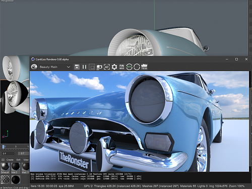

I've just resurrected an old model and have been updating my bitmap textures to find that as the IPR renders, the bitmaps disappear - they just render away to grey on my scene model. If its just a shader with no bitmap image included, they are just fine and render normally. It's only when I use an image in a material! What am I doing wrong or is it a bug?

It's a bug, maybe I did it just recently. Please, help me fix it. Can you show the screenshot from IPR GPU Indicators like a panel at the bottom of the IPR? See example:
http://centileo.com/docs/index.php?COURSE_ID=3&LESSON_ID=39&LESSON_PATH=17.39
To open the panel you should right-click in IPR and enable "Toggle GPU Info".
What numbers are there for texture caches? A screen could be ok. And how many bitmaps are there in the scene? What is the resolution of HDR if it's used?

Thanks for the very speed reply. I've attached 3 screenshots. The issue where the bitmaps fade away appears only yo happen when using a HRDI image as a spherical environment map. If I refresh the cache, the texture reappears but the others disappear and visa versa for each bitmap. Currently there are only only 2 small bitmaps for the headlight and indicators.
The Hdr image is 14796 x 7398 at 320Mb. I didn't realise it so large an image! The problem is fixed by using a much smaller Hdr image as per image 3. All the textures remain unaffected. I must say Centileo is a really superb renderer. It's quality seems quite like Nvidia Iray 2.1 in it's speed but much easier to make materials for. I don't think anyone ever got there heads round Iray as the texture creation was so hard to understand. When Centileo is complete how much is it likely to cost? Finally could you direct me to some tutorials for Shadow Mapping and an up to date manual for the cinema version. This to me seems to be the one thing missing - tutorials.

Texture Fade away bug
This is a bug. The textures for some untested reason compete for their place in cache and one texture looses just everything. I have already seen this for extremelly low cache sizes in other much larger scene in 3ds Max and planned to fix it in some later future. But your caches are great with 700Mb on GPU and 4000Mb on CPU. It shouldn't act like this. So I will need to fix it in the most close release. Please, can you send me your scene in email info@centileo.com or PM. With Cinema 4D quick launches I will be able to fix it faster.

Hi Ron, I have reproduced a bug, now working on it.
