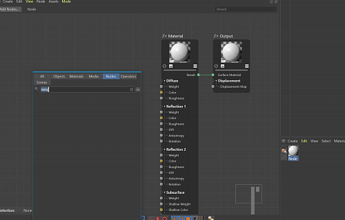

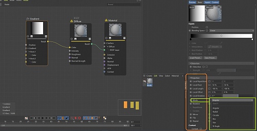

Very happy to see my wish list is on the road. Speaking Ramp, I can't find it in Node editor within CentiLeo material, (instead I find it on its normal material editor) see the picture below. What I mention is that what if we can have a robust Ramp(gradient) node with various types or modes and settings to make lots of thing happen. like C4D gradient node can make lots of patterns (see picture 2), which is really useful for making complex shader for photorealism or artistic expression, the current ramp node is too simple to make it.

Oh in node-based mode CentiLeo has differernt name for Ramp, it's Gradient actually. The Gradient node has no integrated patterns, but it has the Input Map which may accept other nodes as patterns. Also the knots of this node can accept other nodes too.
