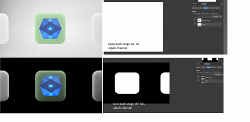

What I mean is that when you render some translucency or transparent object, you need to keep other things on, like to keep back stage on , or other related objects on, so that the transparent effects will look correct (because transparent/ translucency will be impacted by environment and other surrounded objects). But sometimes I want to keep the transparent objects with the same look, just need to change background , so that I need alpha channel for them. The problems is, there is no alpha channel for this scenario. See the picture
in this scene, I want to keep that look above, but that doesn't have alpha channel for the small objects; while, when I turned off the back stage object, it does have alpha channel for the small objects, however, the look for them are different. I want to keep above look, don't turn off back stage, and still have alpha channel for small object.

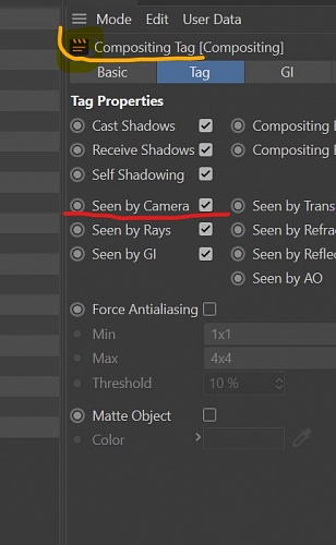

in C4D native renderer, it has a tag called Compositing, you just apply this tag and click off "Seen by Camera", this could be achieved instantly. see picture below;
Administrator  Posts: 972
Sep 16, 2021 13:34
Thanks LU! More or less I understand this. I will test Composite tag more to do something like this.
